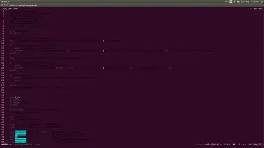

I used neovim in archlinux and colors were working fine, I used rxvt-unicode and zsh. I try to do the same in ubuntu but the colors look like crap. It's dark and not the right colors. Any ideas how to fix this?
set t_Co=256 is set
TERM=xterm-256color is set
$NVIM_TUI_ENABLE_TRUE_COLOR=1 is set...
The colorscheme I'm trying to make work is molokai. And this is what I get... Like crap Thanks in advance.

I had problems with this too - upgrading gnome-terminal is what did it for me.
How can I upgrade gnome-terminal on Ubuntu 14.04 LTS?
Also, I don't think you'll need t_Co=256 in your init / vimrc.
