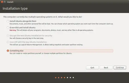

At first I don't know which installation option I should select

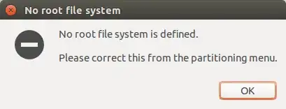

I've tried the option Something else but I'm stumped as to which partition I should select. I get the error message no root filesystem regardless of which option I select

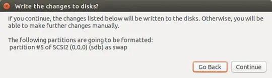

I selected /dev/sdb1 and then the change button in order to select the mount point as / now I can proceed but with the warning

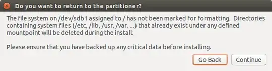

When I proceed I get the even scarier dialog (gonna stop here before I do something I'll regret)

It appears that your Ubuntu system was on sdb1. For a something else install, click on sdb1 and click the Change button. In the drop down box beside Use as: select ext4 and tick the box to format the partition. In the drop down box beside Mount Point, select /. Then click OK and Install Now.
****** WARNING * This will blow away anything that remains on sdb1.* So you will lose any data from your Ubuntu install that you did not back up.
