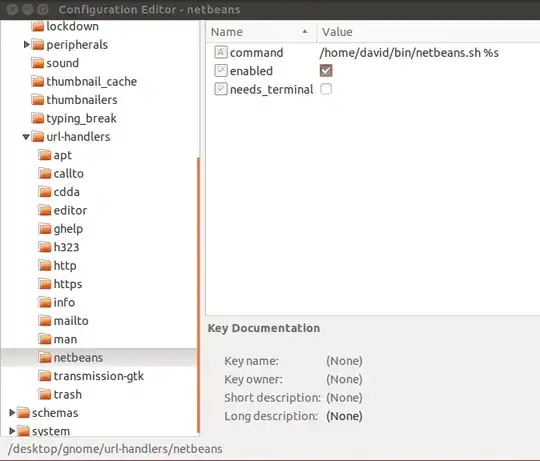

  4. I created a new url-handler in Gnome's gconf:
    gconftool-2 -t string --set /desktop/gnome/url-handlers/netbeans/command "/home/david/bin/netbeans.sh %s"
    gconftool-2 -t bool --set /desktop/gnome/url-handlers/netbeans/enabled true
    gconftool-2 -t bool --set /desktop/gnome/url-handlers/netbeans/needs_terminal false

edit screenshot of gnome config enter image description here
