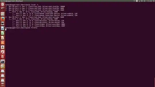

I want to the file from which the command
lsusb -t
retrieves the data. I am curious to see where this is stored.

lsusb reads its data from the kernel provided virtual sys Filesystem mounted in /sys; specifically from the location of relevant directories for USB devices. These devices are connected to different PCI buses and are (mostly) detected by udevd.
For example, in my computer here is one example of the localtion of a USB device connected to a particular PCI bus:
/sys/devices/pci0000:00/0000:00:1d.0/usb4/4-1/

lsusb just reads from relevant file(s) of this directory.
lsusb uses libudev to fetch the list of devices you see. Libudev, in turn, uses a combination of the udev database and searching through the /sys filesystem to find hardware info.

After a quick strace, I found that lsusb keeps a list of VID/PIDs that relate to product names in /var/lib/usbutils/usb.ids
