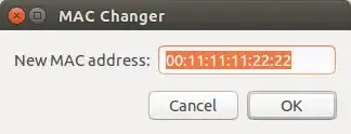

MAC Changer screenshot

  • change-mac-dialog:
    #! /bin/bash
    oldmac=$(get-mac)
    newmac=$(zenity --entry --title "MAC Changer" --text "New MAC address:" --entry-text $oldmac 2>/dev/null) &&
    gksudo change-mac $newmac || zenity --error --title "MAC Changer" --text "Failed to change MAC address"
    Show a nice little GUI prompt asking you to enter the new MAC address (default text is the current MAC). You will be prompted for a sudo password using the GUI gksudo.
