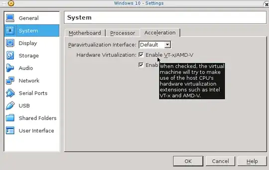

  1. You have it turned off in the Virtual Machine settings (in VirtualBox this setting is under System --> Acceleration --> Hardware Virtualization). See screenshot below for a screen grab of the location...

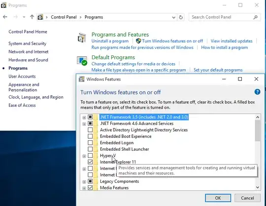

  2. If the above settings are not an issue and you are running a Windows host the problem can sometimes be interference from another hypervisor (like Microsoft’s Hyper-V) using AMD-V. Hyper-V can be inactivated by un-checking its box following this sequence:
     (Windows key + x) --> Control Panel --> Programs -->
     Turn Windows Features on or off --> Hyper-V
