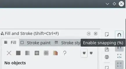

Disabling "apply colors to non Qt applications" worked for me.
If you do not want KDE to override your GTK settings, select Colors -> Options in the System Settings and disable the checkbox Apply colors to non-Qt applications
Sources: https://bugs.kde.org/show_bug.cgi?id=355540 https://classicforum.manjaro.org/index.php?topic=29859.0
Before:

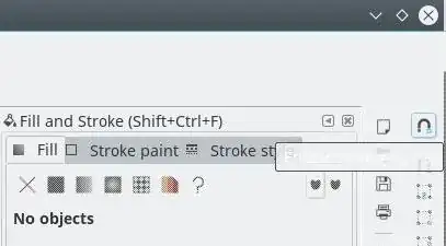

After:
After
