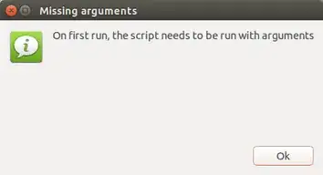

- On first run, arguments *must* be set. After first run, when no arguments
  are used the last set arguments will run, until the script is run with a new
  set of arguments.

        subprocess.call([
            "zenity", "--info",
            '--title=Missing arguments',
            '--text=On first run, the script needs to be run with arguments\n'

  • Copy the script into an empty file, save it (again) as mindpractice.py. Run it with the following options (as examples)
    Must be set:
    p:300                to set the interval between assignments to 5 minutes
    Optional (make a selection):
    a:30-100             to add in numbers from 30-100 (optional)
    s:10-100             to subtract in numbers from 10-100
    m:10-20              to multiply in numbers from 10-20
    d:200-400            to divide in numbers from 200-400
    r:1-1000             to find square root in numbers from 1-1000
  • Example command:
    python3 '/path/to/mindpractice.py' p:300 d:10-100 s:10-30  r:300-600
    to set:
    d:10-100             to divide in numbers from 10-100
    s:10-30              to subtract in numbers from 10-30
    r:300-600            to calculate square roots from 300-600
    while adding and multiplying are not used.
Then the next time, if the script is run with:
It will remember the last used arguments
Use the version that serves your needs best...

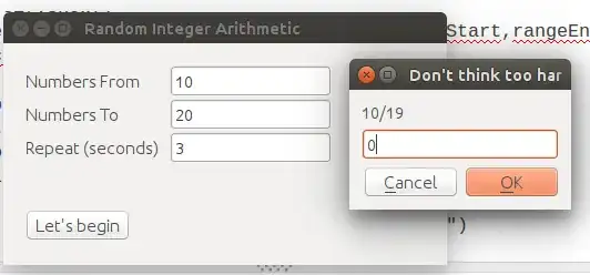

Introduction:
The following application produces random integer expressions to be evaluated by the user. The range of randomly-generated expressions depends on user's settings in the main popup window. Upon clicking Lets Begin button, the session starts indefinitely, until the user hits Cancel button.
Source Code:

class mathApp(QtGui.QWidget):
   def __init__(self):
       super(mathApp,self).__init__()
       self.mainMenu()
   def mainMenu(self):
      self.setGeometry(300, 300, 400, 200)
      self.btn = QtGui.QPushButton("Let's begin",self)
      self.btn.move(20,150)
      self.btn.clicked.connect(self.askQuestions)
      self.lbl1 = QtGui.QLabel(self)
      self.lbl1.move(20,25)
      self.lbl1.setText("Numbers From")
      self.lbl2 = QtGui.QLabel(self)
      self.lbl2.move(20,55)
      self.lbl2.setText("Numbers To")
      self.lbl2.move(20,85)
      self.lbl2.setText("Repeat (seconds)")
      self.le1 = QtGui.QLineEdit(self)
      self.le1.move(150,20)
      self.le2 = QtGui.QLineEdit(self)
      self.le2.move(150,50)
      self.le3 = QtGui.QLineEdit(self)
      self.le3.move(150,80)
      self.lbl3 = QtGui.QLabel(self)
      self.lbl3.move(20,105)
      self.setWindowTitle('Random Integer Arithmetic')
      self.show()
   def askQuestions(self):
       rangeStart = int(self.le1.text())
       rangeEnd = int(self.le2.text())
       sleepTime = int(self.le3.text())
       done=False
       while not done:
          self.show()
          expression = self.generateOperation(rangeStart,rangeEnd)
          correctAnswer = eval(expression)
          prompt = QtGui.QInputDialog()
          text,ok = prompt.getText(self,"Don't think too hard",expression)
          if ok:
             if int(text) == correctAnswer:
                self.showAnswer("CORRECT,YOU ROCK !")
             else :
                self.showAnswer("Nope");
          else:
              done=True
          if done==True:
              self.close()
          time.sleep(sleepTime)
   def generateOperation(self,start,end):
      a = random.randint(start,end)
      b = random.randint(start,end)
      oplist = ['+','-','/','*']
      op = oplist[random.randint(0,3)]
      expr = str(a) + op + str(b) + ''
      return expr
   def showAnswer(self,result):
       popup = QtGui.QMessageBox()
       popup.setText(result)
       popup.exec_()
def main():
   root = QtGui.QApplication(sys.argv)
   app = mathApp()
   sys.exit(root.exec_())
if __name__ == '__main__':
   main()
