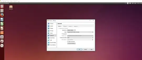

I installed Virtualbox on Windows 10 machine and then installed ubuntu 14.04. But I have a problem with the internet access that I can't connect the ethernet network, while I still normally able to connect in my windows machine. And one thing that I want to ask is in my Network setting, the option Enable Network Adapter is disabled, I can not choose it, does anyone have an idea?
screenshot

I think you need to check the option that says “Cable connected.”

It's disabled because you accessing the settings of your VM while guest OS is running. You should shut it down first, and then try to use NAT instead of Bridged mode.

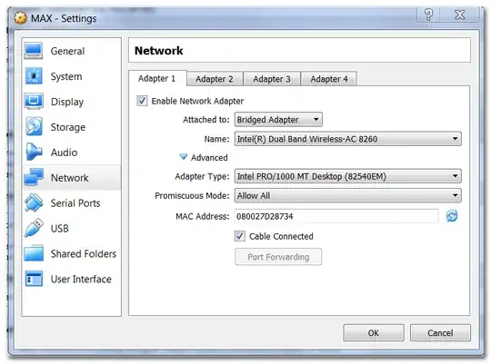

Following settings worked for me:
Screen shot of network setting in virtual box
I also refreshed the MAC number (see the refresh button next to MAC number, press that.)
