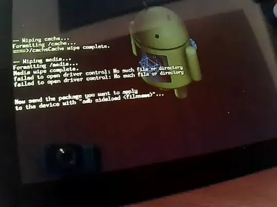

Miracle is that adb reboot recovery works and I am able to get into recovery
sideload
Can anything be done with adb sideload?
