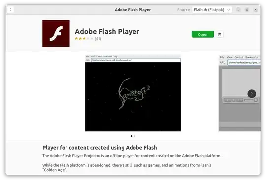

In 22.04 you can install Adobe Flash Player from the software center:
Apparently you need an old version of Adobe Flash Player (before they were self-sabotaged to stop working after a certain time).
It is available here: https://archive.org/details/flashplayer_32_sa_202104
Similarly you can use old versions of browser plugins to make flash work in a browsers. E.g.: https://archive.org/details/flashplayer_old
(Thank god for the archive.org)
Works on Dec 26 2023
