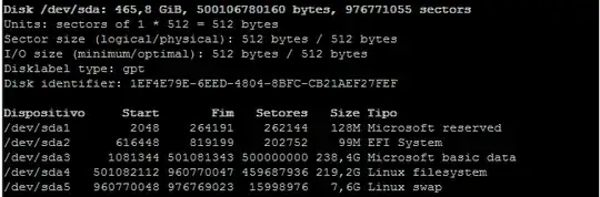

Good afternoon everyone ! I install Ubuntu 15.10 Wily Werewolf next to Windows 8.1. But did not show the option to install next to the windows. So I went to partition manually. Installed Ubuntu ext4 partition on / dev / sda4 and swap on / dev / sda5. The windows were in / dev / sda1, sda2, and sda3. Friends, when I restart it went up in windows. I did a test, and I disabled UEFI boot and left active, only Legacy boot. Now only goes up Ubuntu. I believe this is fully related to UEFI and Legacy. If someone can help me solve .... I've given an update-grub and nothing to solve.
follows print of fdisk -l

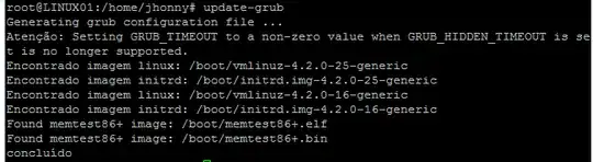

Grub-update Results
In Ubuntu, open a terminal window and run:
sudo update-grub
That should update GRUB's configuration file and recognize your Windows installation.

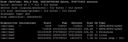

I ran the live ubuntu and formatted by gparted the entire HD. After I created a new partition table ... I created as msdos. The previous partition table was gpt. After I installed windows 8 and then Ubuntu alongside Windows 8 without any problems. It is interesting to all professionals study more about partition tables, EFI and the like.
Now fixed annexed follows the print:
