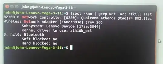

lspci -nn | grep 0280
02:00.0 Network controller [0280]: Qualcomm Atheros QCA6174 802.11ac Wireless Network Adapter [168c:003e] (rev 20)

The wireless adapter is probably blocked by the platform driver.
You can fix it by running
sudo modprobe -r ideapad_laptop
sudo rfkill unblock all
This should unblock it until a reboot.
To make it permanent you can run
sudo tee /etc/modprobe.d/blacklist-ideapad.conf <<< "blacklist ideapad_laptop"
This will permanently disable the platform driver.
