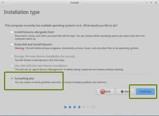

You might see option 'Something else' select it.
now select partition where you want to install ubuntu asign '/' partition and swap partition.
Screenshot while installing Xubuntu
NOTE:- select partition carefully,take important data backups in case you fail.
