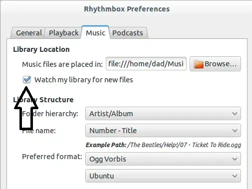

To force rhythmbox to re-read the track and update rhythmdb.xml you need to ensure rhythmbox is watching for new or changed files:
Restart rhythmbox and rhythmbox should after a while update the track information being displayed.
