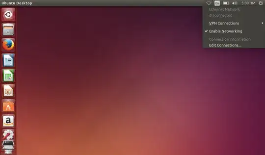

I changed from Windows XP to Ubuntu 14.04! My netbook is 7 years old and i can't connect to WiFi! It's first time i use Ubuntu so please be exact, if you want to help me!
I did this lspci and the result was:
02:00.0 Ethernet controller: Realtek Semiconductor Co., Ltd. RTL8101E/RTL8102E PCI Express Fast Ethernet controller (rev 02)
The lsusb result was:
Bus 001 Device 004: ID 05e1:0100 Syntek Semiconductor Co., Ltd 802.11g + Bluetooth Wireless Adapter
The result of sudo lshw -c network is:
*-network
       description: Ethernet interface
       product: RTL8101E/RTL8102E PCI Express Fast Ethernet controller
       vendor: Realtek Semiconductor Co., Ltd.
       physical id: 0
       bus info: pci@0000:02:00.0
       logical name: eth0
       version: 02
       serial: 00:e0:4c:50:a7:ba
       capacity: 100Mbit/s
       width: 64 bits
       clock: 33MHz
       capabilities: pm msi pciexpress msix vpd bus_master cap_list rom ethernet physical tp mii 10bt 10bt-fd 100bt 100bt-fd autonegotiation
       configuration: autonegotiation=on broadcast=yes driver=r8169 driverversion=2.3LK-NAPI duplex=half latency=0 link=no multicast=yes port=MII speed=10Mbit/s
       resources: irq:25 ioport:2000(size=256) memory:d0100000-d0100fff memory:d0000000-d000ffff memory:d0120000-d013ffff
No internet found.
