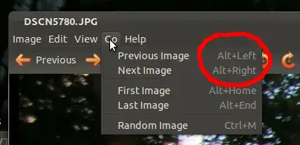

In the gnome image viewer (3.2.0), I would like to change these shortcuts for next/prev image to use the mousewheel. I would also like to change it in shotwell if possible. Current the mousewheel is assigned to zoom in/out on the current image, which I almost never need.
I've tried setting on desktop/gnome/interface/can_change_accels in gconf-editor but no luck.
I have found where I think I should edit, in ~/.config/eog/accels, there are lines like
; (gtk_accel_path "<Actions>/MenuActionsGallery/GoPrevious" "<Alt>Left")
; (gtk_accel_path "<Actions>/MenuActionsGallery/GoNext" "<Alt>Right")
Which I guess I should uncomment (remove semicolon) and assign to something else, but what could be the accel for mouse wheel events?
