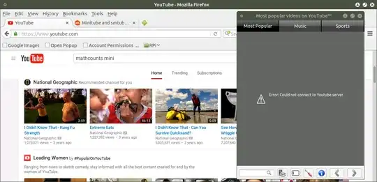

I have a Raspberry Pi running Ubuntu Mate 15.04 and have noticed that Youtube runs pretty slowly on it. I decided to try installing Minitube, but it said that it couldn't download "gdata.youtube.com/feeds/api/..." I tried to install smtube, but it simply said that it couldn't connect to Youtube. I thought this was pretty weird because I had Youtube open in Firefox directly in the background. smtube failure with youtube working in the background
The contents of my hosts file follow:

Is there any reason for Firefox to work, but not smtube or minitube?

I have found the solution, at least for me:
I only wanted a youtube client. mps-youtube works quite well for me.
Nonny Moose
  • 2,315
Got it working by using the following commands:
sudo pip install --upgrade youtube-dl
sudo apt-get install smtube smplayer
In smtube, select the the dl program.
