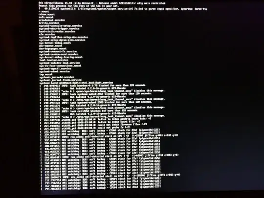

My goal is to create a dual boot system with Ubuntu 15.10 and windows 10.
I followed this guide https://help.ubuntu.com/community/UEFI and other web articles. I tried to run the live version from a USB stick and also to install it to HD.
I also tried to do the same thing with Lubuntu 15.10 and Fedora 23. Every time the starting console log is roughly the same (this is from Ubuntu, after 10 minutes waiting)
Console log
I think the problem could be the WIFI card. Here it's explained that it's necessary to update the firmware, but since I cannot log into Ubuntu I don't know how I can do it.
By the way I managed to get it working launching Fedora in light mode. In the network panel there wasn't any reference to my WIFI card. Maybe it worked because it skipped the card configuration.
Is there any way to install Ubuntu 15.10 from a USB stick?

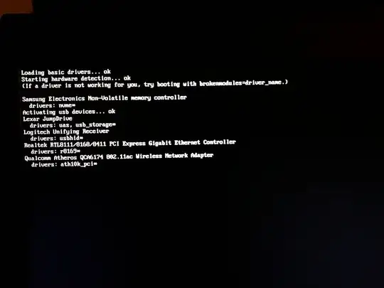

I tried also OpenSuse, and this is the log I had
OpenSuse
Once more it stops by the atheros module

6700HQ is a very new Skylake CPU and not well supported yet. Try booting with kernel parameter nomodeset. Alternatively you might be able to get modesetting to work by installing a recent mainline kernel and booting with i915.preliminary_hw_support=1.
It looks like your kernel is also reporting kernel bug #109081 - Freezes with Intel i7 6700HQ (Skylake). It might help to boot with kernel parameter intel_idle.max_cstate=7. You might also benefit from installing the latest upstream kernel and any firmware updates for your laptop.
The latest 16.04 daily should work better than 15.10.
