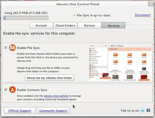

As such, it is not working personally for me at the time of this writing. However, the way one would set up the contact sync is through the Ubuntu One control panel interface:
Screenshot of Ubuntu One control panel
What I've done is that I've disabled and then reenabled the Contacts Sync on Ubuntu One Control panel and restarted Thunderbird and all the contacts were then there.
  1. Open Ubuntu One.
  2. Create/login with your Launchpad ID.
  3. Click on Services.
  4. Make sure Enable contact sync is marked.
There, you are done.
