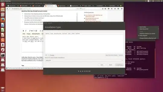

I have been struggling to install Ubuntu on my laptop, I want to make a dual-boot Windows/Ubuntu, but I just can't install it. Already changed my BIOS to AHCI and UEFI, but had no effects so far.
During the installation processes, I´m not even given option to install alongside Windows. After setting language and Internet connection it jumps directly to this screen.
Ubuntu-Install
It is also very strange because I can find it when using sudo lshw -class storage -class disk. What should be my next steps?

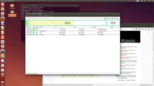

Just to help you guys this is the data from GParted:
GParted_Partions

In the end all this BIOS tunning didn't played any role on my problem, as Grahammechanichal suggested I set my bios back to legacy boot and managed to install using a tool called FixParts. Aparently the problem is related to GPT data.
  1. So the first step was to boot using your USB Stack or CD/DVD and select "Try Ubuntu".
  2. After doing that just load terminal using Ctrl+Alt+T
  3. And launch FixParts to fix it...it can correct the problems almost automatically. See Rod Smith's answer for more details.
