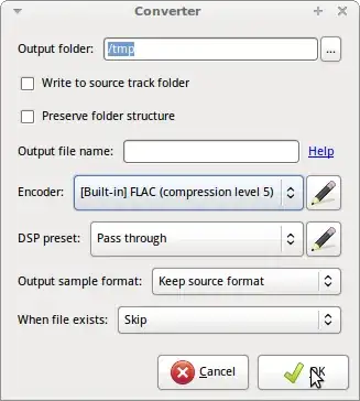

Add your DSD files using the Add files or Add folders options on the File menu. This will import your files into the DeaDBeeF list.
Right click the files you want to convert and click... Convert:
Converting DSD files with DeaDBeeF
In the next dialog, set where you want the files saved, and choose the FLAC encoder:
Click OK and the FLAC files will be generated.
