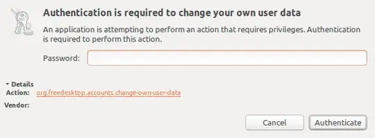

Every now and then (only after resuming from Suspend) I get the following dialogue.
The information provided is not enough for me to decide what to do (hence I cancel of course :-)
The link in the Details section leads nowhere.
My guess is that there is some program (A) asking some service (B) for permissions.
I want to know how to find out what service/program (B) generates this dialogue (hints about the program (A) requesting the permissions in the first place are welcome too :-))
Ubuntu 15.10
Further investigation spurred by waltinator's answer shows polkitd to possibly be part (B)
Excerpt from journalctl (linebreaks inserted to prevent scrolling)
Jan 10 12:22:04 big polkitd(authority=local)[1157]: Operator of unix-session:c2
   FAILED to authenticate to gain authorization for action
   org.freedesktop.accounts.change-own-user-data
   for system-bus-name::1.68
   [/usr/lib/x86_64-linux-gnu/indicator-messages/indicator-messages-service]
   (owned by unix-user:g)
Jan 10 12:22:04 big dbus[1045]: [system] Rejected send message, 9 matched rules;
   type="error", sender=":1.4"
   (uid=0 pid=1117 comm="/usr/lib/accountsservice/accounts-daemon ")
   interface="(unset)" member="(unset)" error
   name="org.freedesktop.Accounts.Error.PermissionDenied"
   requested_reply="0" destination=":1.68"
   (uid=1000 pid=3973 comm="/usr/lib/x86_64-linux-gnu/indicator-messages/indic")
Thanks to waltinator's suggestion about xwininfo (which doesn't tell the pid of the window's process) I now found wininfo. So I was able to confirm that the window is created by /usr/lib/policykit-1-gnome/polkit-gnome-authentication-agent-1.
Now I want a way to ask polkitd/policykit which program requested which action, but that needs a new question.

This bug has been resolved: https://bugs.launchpad.net/ubuntu/+source/policykit-1-gnome/+bug/1512002
You can install the updated package (must enable 'proposed' repo) which modifies the policy:
/usr/share/polkit-1/actions/org.freedesktop.accounts.policy
- <allow_any>auth_self</allow_any>
- <allow_inactive>auth_self</allow_inactive>
+ <allow_any>yes</allow_any>
+ <allow_inactive>yes</allow_inactive>
"Currently, data/org.freedesktop.accounts.policy.in specifies that a user must be active in order to set his own data." -alkisg
"I can't think of any reason why having a session would be important in this case, so I think changing allow_any to yes should be fine." -mdeslaur
"This bug was fixed in the package accountsservice - 0.6.40-2ubuntu12" -janitor
