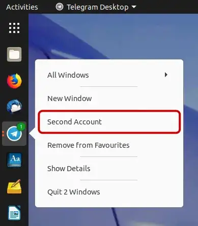

If you still want a tidier option using the abumalick's answer, you can add additional action(s) to the original launcher to add extra profile(s).
  1. cd ~/.local/share/ goes to the directory where Telegram Desktop data are stored under your home hierarchy;
  2. mkdir Telegram2 makes a new folder for the second Telegram profile;
  3. gedit applications/telegramdesktop.desktop opens Telegram Desktop launcher in text editor;
  4. Finally, add the following lines to the end:
(Address the Telegram executable file for Exec and also replace your username instead of $user)
Actions=SecondAccount;
[Desktop Action SecondAccount]
Name=Second Account
Exec=/home/$user/complete/address/to/the/Telegram -many -workdir /home/$user/.local/share/Telegram2
You may need a log out to see the changes take effect. Here’s how it looks on Ubuntu 20.04:
Telegram Desktop second instance
– tested on the latest Telegram v2.0
AliNajafies
