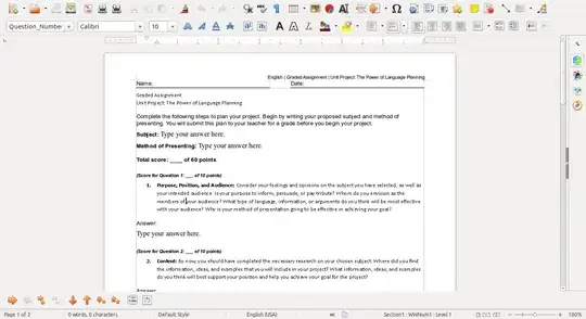

I'm having an issue with Windows fonts not being smoothed in Ubuntu 15.10. I copied the contents of the Fonts directory from my Windows 10 install to /usr/share/fonts/truetype/windows10 and ran fc-cache -fv. Afterwards, I rebooted, and the fonts seem to work, but they are not smoothed. Screenshot below. What's odd is that they are smoothed in the font selection menu, but not in the document. Another thing that's odd is that the i, f, and t characters are smooth, but not the other ones. How do I fix this? I'm running the latest Libreoffice 5.0.4 from the Libreoffice PPA (ppa:libreoffice/ppa).
EDIT: I've confirmed that the font smoothing issue is system-wide.
bad font smoothing
