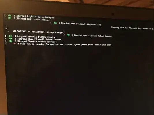

Is it possible to make ubuntu shutdown right away instead of counting to 1.30min then shutdown. PS: It is a script that is running that gives the message.

As I already mentioned in comments, setting DefaultTimeoutStopSec in /etc/systemd/system.conf should solve this problem.
