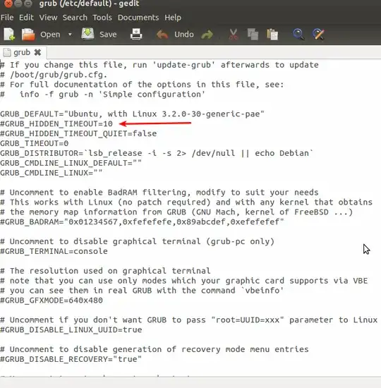

The issue is solved by modifying the parameter GRUB_HIDDEN_TIMEOUT in the /etc/default/grub file (need to be super user to modify it), and (as always to apply configuration changes made in this file) running sudo update-grub.
Changing the value from 0 to some positive value allows to enter the GRUB menu by pressing Shift during boot.

  2. Run gksu gedit /etc/default/grub.
  3. Change the GRUB_HIDDEN_TIMEOUT line as above, save it, and close gedit.

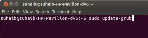

  4. Run sudo update-grub. You can now restart.

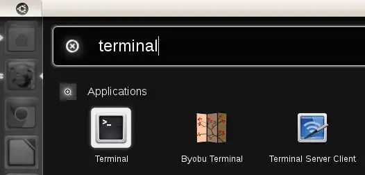

To open the terminal:
Open Dash (Super Key) or Applications and type terminal
For older or Ubuntu versions:
Applications -> Accessories -> Terminal
Then type the command gksu gedit /etc/default/grub
and then change the value in GRUB_HIDDEN_TIMEOUT as above.
Save it and close the editor.
