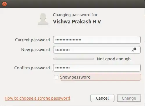

I recently changed my Ubuntu login password. But now I want to change it back to the old password. But when I try that. It shows "Not good enough".
It was a strong password when I had set it for the first time. enter image description here

You can just alt to root and change your password like that:
root@hello:~# passwd Your_Name
Enter new UNIX password:
Retype new UNIX password:
passwd: password updated successfully
root@hello:~#
It doesn't care about the password history.
Or, you can chose a random password this time(like asdkjhavbaudifsd) and then change it back to your previous password.
