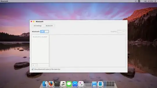

hello please help guys i cant enable blue tooth in my laptop

Use hardware buttons to enable ... Might be fn+F2 or F3 or F* depending on your laptop
Aadhil
  • 394
Bluetooth might be soft locked. To check that run
rfkill list
If you see your Bluetooth being soft blocked issue
sudo rfkill unblock *<device id>*
or sudo rfkill unblock all/sudo rfkill unblock bluetooth
