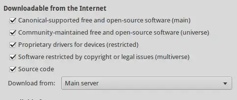

You can get any source code from the repository’s, first open software and updates and check source code
Now you can use the source parameter in apt to pull any source right from the repos, xrandr is part of x11-xserver-utils, so use this command
apt-get source x11-xserver-utils
