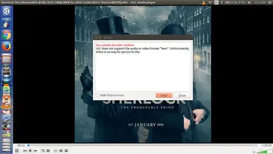

I am not able to play any HD .mkv files in vlc. (No problems with low quality videos). Here for example,
It says "Unfortunately there is no way to fix this", really???

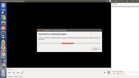

when the same video is played in Videos, I get this:

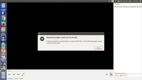

And.... this:

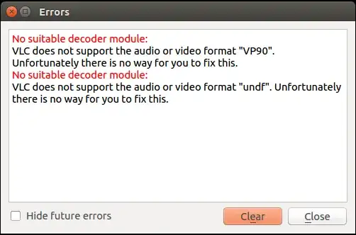

Some times I get a little bit different error messages (for a different video)
That goes like this:

HEVC and VP9 decoders are missing on your system. To install VLC HEVC plugin try:
sudo apt-get install vlc-plugin-libde265
You could also try out MP4Client Player from GPAC.
Edit: GPAC will for sure play HEVC content but I'm not sure if it also supports VP9. Please ensure to install Latest available binaries from the GPAC site and avoid using apt-get install gpac in this case.
sudo apt-add-repository ppa:strukturag/libde265
sudo apt-get update
sudo apt-get install gstreamer0.10-libde265
sudo apt-get install gstreamer1.0-libde265
