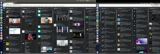

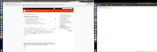

I have two monitors. I have multiple workspaces. I want my launcher ("launcer placement" in settings > displays) to be present on both my monitors in the one workspace, but have only one launcher (on the main monitor) in the other workspace. This is because I want to stretch Tweetdeck across both monitors and the launcher gets in the way. Is this possible?
Workspace 1 (Good):
Image 1
Workspace 2 (NOT Good):
Image 2
Workspace 2 (Good):
Image 3

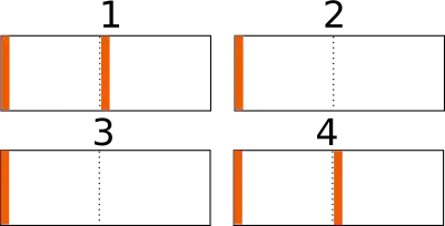

The script below automatically keeps track of which is the current workspace (no matter how many workspaces you have and in what configuration).
This script is run with the workspaces, where you want the launcher only on the left, as an argument. An example:
If you run the script with the command:
python3 /path/to/launcher_pos.py 2 3
The result is:
