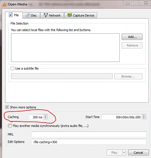

Unfortunately I'm not able to comment yet. Can you run VLC with -vvv option:
vlc -vvv video.avi
and provide some output so we can better understand what is happening there. Thanks.
Edit: You also could try to increase Caching value in VLCs settings. Go to Media -> Open Multiple Files then go to File tab and set the checkbox Show more options:
