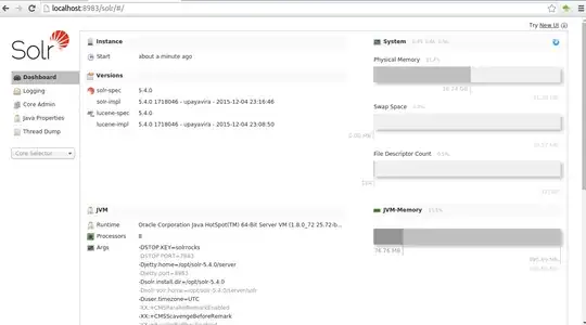

Which version of solr you are using? I am using solr5.4 and it's working all fine
root@ashu-700-430qe:/opt/solr-5.4.0# bin/solr start
Waiting up to 30 seconds to see Solr running on port 8983 [/]
Started Solr server on port 8983 (pid=5509). Happy searching!
I am also using Oracle Java 8
And my logs are also working fine. Here is the listing with permissions:
root@ashu-700-430qe:/opt/solr-5.4.0/server/logs# ls -lrt
total 176
-rw-r--r-- 1 root root 41795 Jan 10 08:02 solr_log_20160216_2032
-rw-r--r-- 1 root root 49305 Jan 10 08:02 solr_gc_log_20160216_2032
-rw-r--r-- 1 root root 26960 Feb 16 20:33 solr_gc.log
-rw-r--r-- 1 root root 25547 Feb 16 20:33 solr.log
-rw-r--r-- 1 root root 22764 Feb 16 20:33 solr-8983-console.log
P.S. I install good amount of tools as root as I do a lot of evaluations. I just downloaded the solr5.4 zip file and unzipped into /opt - very much OOTB installation with no setup or configuration. You can install Apache SOLR from here
Ashu
