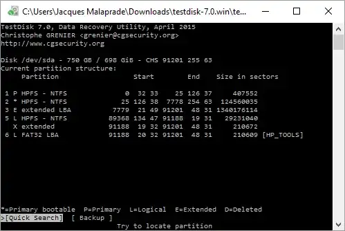

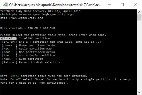

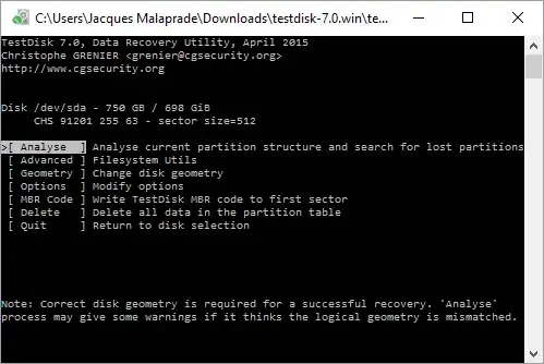

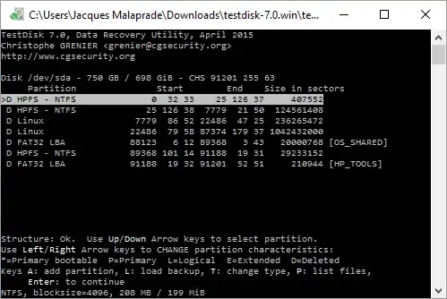

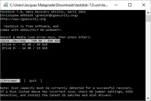

I have tried to upgrade my windows from 7 sp 1 to 10 using the MediaCreationTool.exe as suggest in this page - howtogeek. It did not work as suggested and part way through the upgrade I was faced with a grub rescue prompt. I found some help with this at this page - grub-rescue. I couldn't make the highest voted method work due to being unable to find the bootable partition using ls (hd0,msdos6)/ etc. etc., so used the second highest voted method which requires booting from a rescue-usb and running boot-repair. The boot-repair log is here - pastebin. During the boot-usb session I noticed that the linux partitions are marked as unknown. Upon restart the windows 10 upgrade continued and finished as expected, except the boot menu doesn't appear with the option to boot into Ubuntu. I tried the advice on this page - boot-repair doesn't work. Setting both bcdedit /set {bootmgr} path \EFI\ubuntu\shimx64.efi and bcdedit /set {bootmgr} path \EFI\ubuntu\grubx64.efi in windows commandline with admin privilege didn't help. I tried to run TestDisk to regain the partitions that were lost. I am completely confused how to do this correctly. When I run TestDisk the list of partitions look like this after the quicksearch.
enter image description here enter image description here enter image description here enter image description here enter image description here
I need to get them back to the way they were and feel way over my head with the options available. Help will be much appreciated. If anyone can just inform me which were my primary, logical and extended partitions it would help.

I am suggesting that the partitioning scheme in testdisk could look like this below. Although I need advice on this.
Disk /dev/sda - 750 GB / 698 GiB - CHS 91201 255 63
     Partition               Start        End    Size in sectors
 P HPFS - NTFS              0  32 33    25 126 37     407552 [SYSTEM]
 * HPFS - NTFS             25 126 38  7779  21 50  124561408
 L Linux                 7779  86 52 22486  47 25  236265472
 L Linux                22486  79 58 87374 179 37 1042432000
 L FAT32 LBA            88123   6 12 89368   3 43   20000768 [OS_SHARED]
 L HPFS - NTFS          89368 101 14 91188  19 31   29233152
>P FAT32 LBA            91188  19 32 91201  52 51     210944 [HP_TOOLS]
I need to have the win10 partition (2nd NTFS partition) to be bootable and the linux partition (1st linux partitoin) to be bootable. It seems that making the linux partition logical is the only option, as otherwise I get Structure: Bad. instead of Structure: Ok.. Is it OK to play around with this a bit without destroying the data on the PC?
