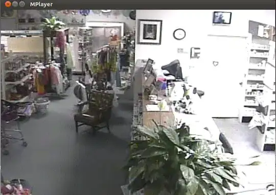

Now play your video - e.g.
mplayer http://samples.mplayerhq.hu/V-codecs/IMM4/200707170736151.avi
