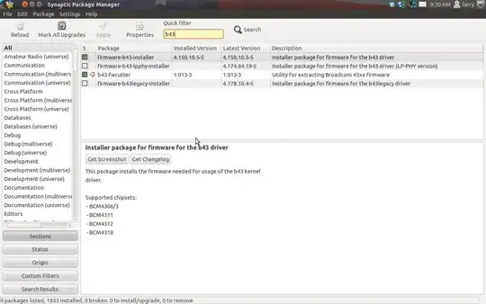

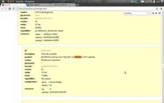

1st you need to identify your driver, and they way I do that is get a list of my hardware on my computer. Open terminal and see if the program that you need is installed. More than likely it is.sudo apt-get install lshw lshw is a Hardware Lister. If and when the program is loaded, now you can send a copy of your hardware to your home folder and you can save it in you Ubuntu One or Dropbox folder to keep as long as you have your laptop. Now in terminal type sudo lshw -html > your-file-name.html and if you want you can change where it says your-file-name to whatever you want. When the program is complete just go to your home folder and open the html file created. It should open with Firefox, Chromium, Chrome... When it is open, scroll down to where your wireless lan controller, it should look like this. enter image description here Under configuration on my laptop it says its a b43 driver. Now I downloaded the older Synaptic Package Manager in the USC (Ubuntu Software Center). After downloading I opened the Synaptic Package Manager a did a search on B43 and this is what I got; enter image description here Notice what choices I made and the choices I did not make. If we are lucky and the drivers are same, all should work. If you have a different driver then search what your driver is. With a little good luck it should work.
