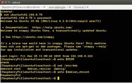

${debian_chroot:+($debian_chroot)} insertion depends on the presence of $debian_chroot variable or /etc/debian_chroot file.
Here's a simple example. In the screenshot bellow I'm connected through ssh to my Raspberry Pi with Ubuntu Snappy on it, which has $debian_chroot variable set ( by default ), while my laptop's Ubuntu does not. You can see the resulting prompt in the tabs, and in both cases variable for $TERM is xterm
Now if the variable $TERM was something else, it wouldn't alter the GUI terminal title. That could be connecting to a screen session, for example, where variable $TERM is screen.
