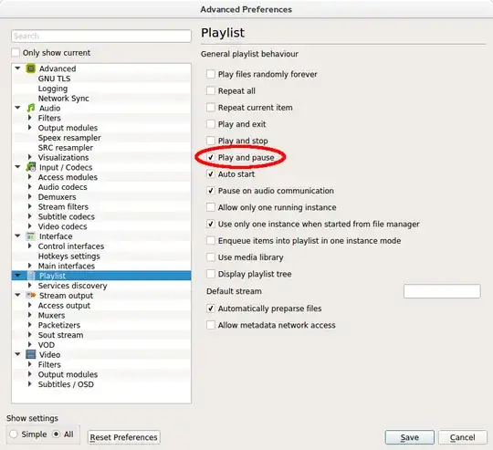

You'll probably want to tick Tools -> Preferences -> All -> Playlist -> Play and Pause so that the images won't be played as a slideshow (this changes the default behavior; playing a specific playlist will override this settings with the playlist's setting):
s1
