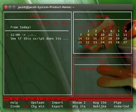

The output of the command:
calcurse -a
looks like:
12/29/15:
 * Free today!
 - 12:00 -> ..:..
    See if this script does its job :)
