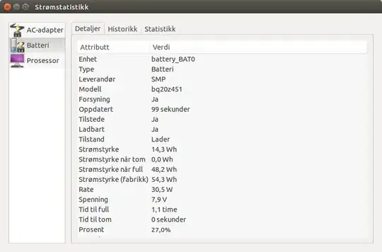

it says updated and then 99 seconds
You can see that in the picture it says updated and then 99 seconds.
