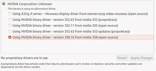

I have Ubuntu 14.04 duel boot on an Dell Inspiron 7559 laptop with Windows 10. My graphic card is NVIDIA® GeForce® GTX 960M 4GB GDDR5
I installed NVIDIA video card driver following this question. And I choose the driver NVIDIA binary driver version 358.16. enter image description here
The problem is, my laptop could not recover from suspend. The laptop will show a color vertical stripes after recovery. Then the system has no response. Ctrl+Alt+F1 etc don't work either. I have to hard reboot the laptop.

Therefore, I believe my suspend problem is due to the video card driver. Then, my question is, as the NVIDIA website mentioned, is there Ubuntu's own packages fo the graphic driver for GTX960M? If so, where can I find them?
I tried the first driver in the list. The system will completely dead once a few minutes. My hibernate feature also doesn't work. I do have enough swap space. For more than half of the time, the laptop cannot recover from hibernate and get stuck at a black screen with a flashing curse. Therefore, I really want to solve this problem. Otherwise I cannot carry my laptop around without turn it off.

I don't have enough rep to comment. I got Xubuntu 15.10 working on my Inspiron 15 7559, which has a GeForece GTX 960M, with functional suspend mode and the ability to switch between integrated and discrete graphics.
See my answer here:

The version that Ubuntu currently ship is 352.63. There are 2 packages. The one called "nvidia-352" and the other is "nvidia-352-updates" (Most if the time they have different versions but that's not the case currently). This is Nvidia's current long-lived driver branch (aka stable driver).
I have the same card as yours but on 15.10 and 358.16 driver. When the computer return from suspend it sometimes make artifacts in the apps that stores textures on the gpu but the computer is completly responsive.
