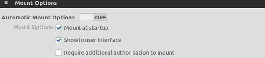

This Steam error occurs because your drive is mounted by root and you don't have execute permissions on the drive (I think). You can use the disks app to change this.
Search disks in the dash, highlight your drive and under the usage image is a small cog icon, click this and edit mount options, now make your settings look like this
Leave the rest as it is and reboot. Now your drive can be found in /mnt and is auto mounted as your user at boot.
This is how I fix this error in 14.04, NTFS drive.
