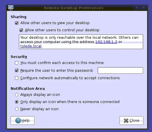

Regarding the first part, I personally use vino. There is a quick setup guide for vino.
Install vino:
sudo apt-get install vino
Configure vino:
vino-preferences
By default, it open this windows :
alt text
If you can redirect your display, you can make that windows pop on another computer. If not, you'll need to check the vino man page to find out how to make the same configuration .
