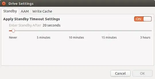

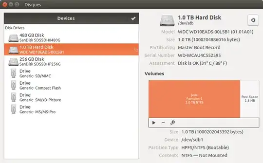

The gnome-disks utility shows a "standby timeout" option: enter image description here enter image description here

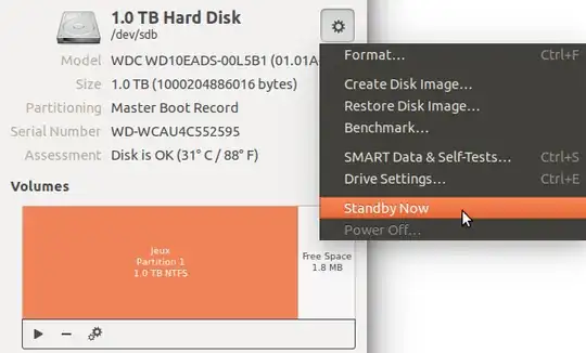

The hard drive never gets to sleep automatically; I can manually put it to sleep/wake it up with the gear menu: enter image description here
Why does my drive doesn't automatically go to sleep? How can I make it go to sleep automatically after no activity?
