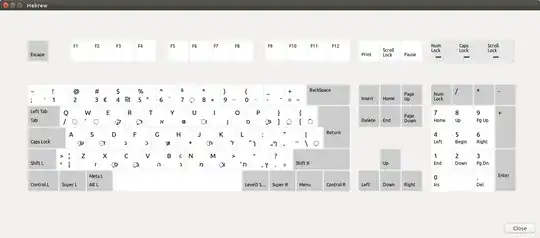

I just installed Hebrew keyboard, tried to enter ף ץ ת and ;,. using a Keyboard Layout Chart and did not encounter a problem. To show the chart, in status bar click the language icon > Keyboard Layout Chart.
If you need to display character from right bottom corner of the button on this chart, use combination with the Alt button on the right side Alt Gr. For example Alt Gr + > will give you comma: ",".
This chart will also tell you what characters will be displayed after using Shift (upper left side).
To activate alternative keys, go to main Ubuntu Settings > Keyboard and in the Shortcuts tab under Typing set Alternative Character Key to Caps Lock.
