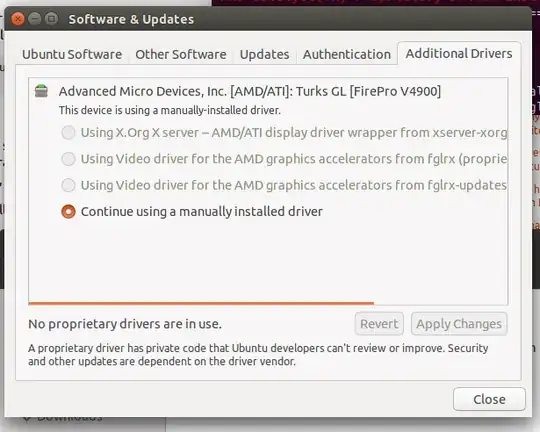

I am trying to update my driver and see this screen. It doesn't allow me to update the driver. Note the greyed out options. How can I fix this? enter image description here
EDIT: Revert to open source graphics drivers - options greyed out 14.04
$ lspci -k | grep VGA -A2
03:00.0 VGA compatible controller: Advanced Micro Devices, Inc. [AMD/ATI] Turks GL [FirePro V4900]
    Subsystem: Advanced Micro Devices, Inc. [AMD/ATI] Device 2b06
    Kernel driver in use: fglrx_pci
but when I do
$ sudo apt-get remove --purge fglrx_pci
Reading package lists... Done
Building dependency tree
E: Unable to locate package fglrx_pci
Even tried following steps at https://askubuntu.com/a/190187/393311 but still am stuck with fglrx_pci and options are greyed out.

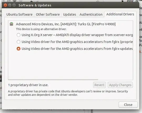

I am past the greyed out options but the display is all screwed up and it is using software renderer. enter image description here
Took a chance and selected fglrx-updates. Logged out and now the display is at proper resolution. Final setup:
$ sudo lshw -c video
[sudo] password for siddjain:
  *-display
       description: VGA compatible controller
       product: Turks GL [FirePro V4900]
       vendor: Advanced Micro Devices, Inc. [AMD/ATI]
       physical id: 0
       bus info: pci@0000:03:00.0
       version: 00
       width: 64 bits
       clock: 33MHz
       capabilities: pm pciexpress msi vga_controller bus_master cap_list rom
       configuration: driver=fglrx_pci latency=0
       resources: irq:60 memory:c0000000-cfffffff memory:d3d20000-d3d3ffff ioport:7000(size=256) memory:d3d00000-d3d1ffff
