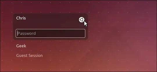

You could install gnome as a desktop environment within Ubuntu. You don't have to install elementary or gnome as a separate distro.
To install Gnome:
sudo apt-get install ubuntu-gnome-desktop
You can find out how to install the pantheon desktop here.
To choose which environment you want to use, click:
(source: howtogeek.com)
