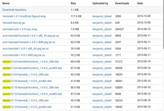

What makes you think it's not available? It's right there in the official repositories. You just need to install it:
sudo apt-get install heimdall-flash heimdall-flash-frontend
There are also .deb packages right there in the link you posted in your question.
When I look at the page you linked, I see a lot of support for Ubuntu:
I would appear that he has not released one since 2013 for Ubuntu, but that supports 13.10, and most stuff on 13.10 works on 14.04 and newer.
I just downloaded ubuntu13.04-heimdall-frontend_1.4.0-0_amd64.deb and ubuntu13.04-heimdall_1.4.0-0_amd64.deb and they both installed fine with no dependancy issues. Bear in mind I had to use the command dpkg -i /path/to/downloads/ubuntu13.04-heimdall-frontend_1.4.0-0_amd64.deb rather than software centre.
I guess you want it to be supported on 14.04 officially - that's not sommething we can answer here. You could speak to the developer and tell him that the 13.10 files work on 14.04?
