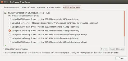

I have /etc/modprobe.d/nvidia-358_hybrid.conf which contains the following
# This file was installed by nvidia-358
# Do not edit this file manually
blacklist nouveau
blacklist lbm-nouveau
alias nouveau off
alias lbm-nouveau off

And here is the "Additional drivers" tab from "Software and Updates": The "Additional drivers" tab from "Software and Updates"
